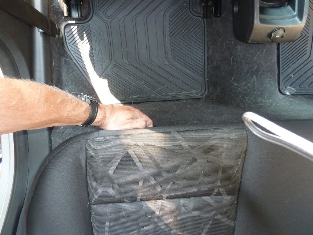

1. Remove the rear seat cushion. There are two clips just under the front edge of the seat about 8" or 10" in from either side and 1.5" to 2" from the front edge. You might be able to see them if you have a mirror and a flashlight but you can feel them under the front edge of the seat. They both push toward the passenger side of the car to release the seat cushion while you are pulling it up.
Here is the passenger side

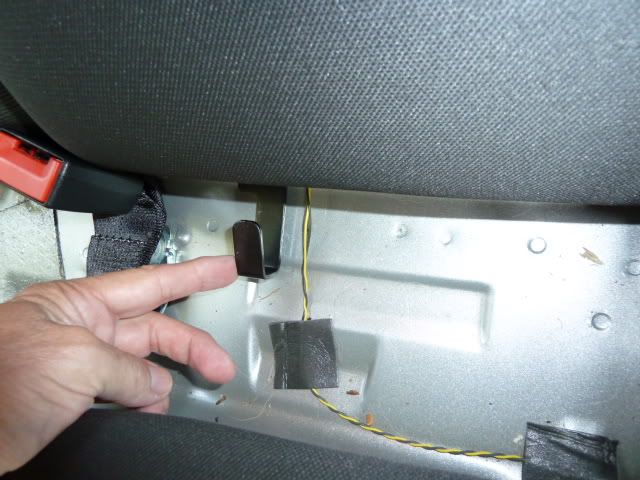

And driver side
Here is the clip after the seat is removed

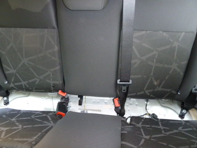

Here you can see the three clips at the rear of the seat cushion
Here is a close-up of one of the clips

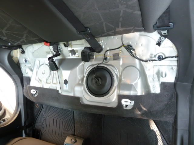

After the seat is out it looks like this

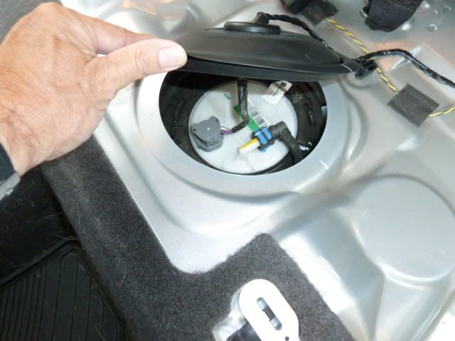

2. Now pull out the 8" dia. rubber cover
3. Unplug the electrical connection.
4. Unclip the blue clip on the fuel line.
5. Use a screw driver and hammer to tap the 6" dia. locking ring counterclock-wise. You're done.
